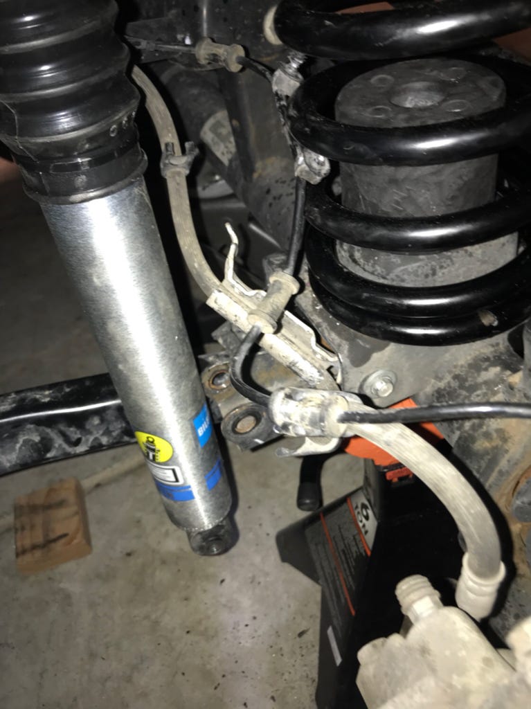

The bracket itself bent . What are some other strategies? I tried channel locks, pipe wrench, hammer
it will bend you need two quality pair of channel locks or one quality channel locks and a quality vice grip. I have don probably 20 of these and just show it who's boss.

on newer wranglers the factory brake lines are longer than the brake lines that come with the metal cloak 3.5" game changer lift. We installed the mc on my buddy's rig and compared the oem brake lines on his 2016 and they were slightly longer than the brake lines that came with the kit. I have used this method on a RK 3.5" with long shocks with no issues.
use one set of channel locks or vise grips to hold the flat portion and pry with the other set on the curved portion that is surrounding the brake line.

Do you grip the small rounded part and bend back the back part of the bracket, or, grip the back part of the bracket and try to get a grip on the round part? Last night I was concerned of crimping the bracket on the hose and making it worse. I couldn’t seem to get my channel locks to grip.

both hold the flat back part and the round part and pry them apart opening up the gap. get the lip of the channel locks in the gap being careful not to pinch the brake hose.
