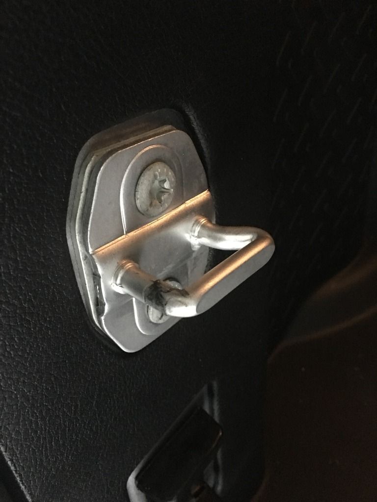

Put about three wraps of electrical tape around the latch hoop of the tailgate, if it's the tailgate that should temporarily fix it.
Ironically, thats where i think its coming from... the electrical take is a great idea...

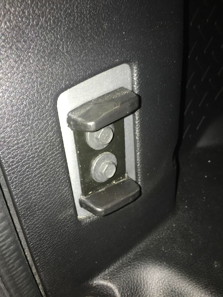

#10 ·
Check to make sure the rubber bumper is still present on the tailgate alignment bracket. If that isn't there, the tailgate may not be held tight and will clunk from time to time... Mine did.
Make sure the there is no play with the gate. Lift up and down on the end of gate while open - a loose hinge will show itself here.
Look on Part Number 14. There is a rubber bumper there.
Also, make sure all your brackets are tight. Look for abnormal wear on part 14, 12, and 10.

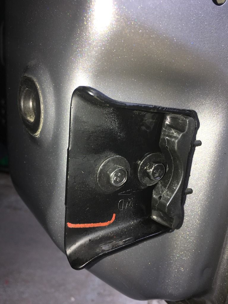

#13 ·
Does this look correct??

#25 ·
I have this same issue, but it's more noticeable when I'm going in reverse at slow speeds. My brother-in-law said it's possibly the latch to the tailgate not seating correctly and said to unbolt the catch latch on the tub and move it more forward. Haven't tried this yet so I can't say it will work but he had a 2010 JK and is a mechanic.

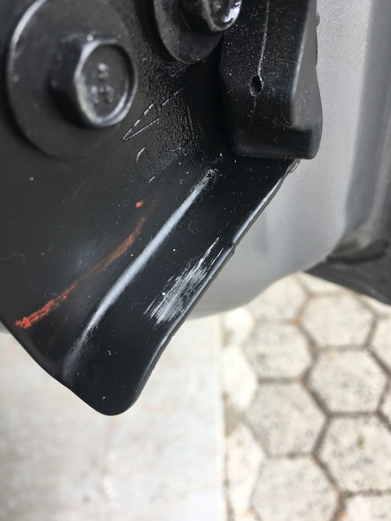

#28 ·
Ok its Definitely here, look at the scratch top and bottom!! so what's the adjustment and fix??
#29 ·
EDIT: dont worry about the scratches on that metal plate, they are normal. its just the metal plate centering the tailgate where it needs to be. adjusting it will tighten up the whole tailgate
try loosening up the plate in the last picture, then moving it towards the rear of the jeep about 1/16" to 1/8" and up slightly. this will tighten up the whole tailgate and hopefully eliminate the clunking.
i had the same issue and this is what resolved it.
