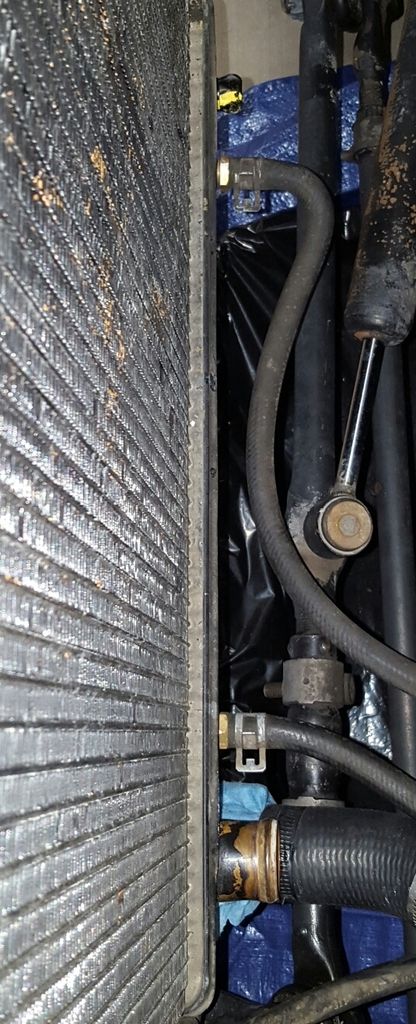

There is a crappy aftermarket steel 3 core in there now, needs replacing, want to go back to OEM.
It (new OEM I am buying) has the quick disconnect connections for the transmission lines - the aftermarket (currently in Jeep - one I'm replacing) has the 3/8" barbed nipples on it. When I saw the setup, I didn't take possession of it, if it doesn't work out I don't want to get stuck with 15% restock fee.
At the dealer the only options are full lines at $150 after tax - I haven't looked but can both lines be replaced easily? If I have to go that route, which I'd rather not.
What are other options? I do not think the male end of quick disconnect is available anywhere but if they please share who makes them.
I'd hate to void my warranty, especially after seeing the condition of that box and the amount of dust on the radiator but can the male end of the disconnects be removed and replaced with a standard hose barb fitting?
Thanks

Here is what I currently have - these rubber cooler hoses connect to hard line under the ps pump with oem clamps. Connected to radiator with oem clamps onto brass hose barbs. (pic at the bottom of this post)
Those look kind of like the connection on the new OEM radiator, I have rubber hose at the radiator end, I think I'm wrong in my first post, I think (could be wrong) that the radiator has the female end and the line would have a male end hard line tip connected to the rubber - IDK, I'm lost....I can't find a pic of the line they sell, just a drawing.
Buy a few feet of 3/8" transmission hose and four hose clamps and be happy. Later year models came fron the factory that way.
How would I connect to the new radiator? It has a connection very similar to what Sinister linked to.

These are the lines sold at dealership - from cartoon, it appears that there is a hard line that plugs into radiator connection.
It has the quick disconnect connections for the transmission lines - the aftermarket has the 3/8" barbed nipples on it.
In any case, I suspect it would be possible to replace the QD fittings with hose barbs. Unfortunately, thread size varies with manufacturer, so finding the correct size might be a challenge. The current ones might or might not fit.
Buy a Mopar radiator for an '02 - '04 model. (p/n55037654AB)
It will come with hose barbs that should work for your current configuration.
